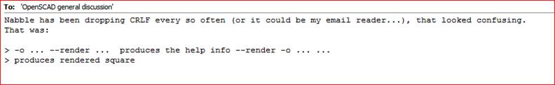

Michael Marx
Tue, Dec 19, 2017 1:28 AM
Nabble has been dropping CRLF every so often (or it could be my email reader...), that looked
confusing.
That was:
-o ... --render ...  produces the help info
--render -o ... ...  produces rendered square
Sent: Tue, 19 Dec 2017 12:25

Michael Marx
Tue, Dec 19, 2017 1:37 AM
Aaargh
cmd options> -o ... --render ...
cmd options> --render -o ... ...
Like so:
"C:\Program Files\OpenSCAD\openscad.exe" -o 2d_exe.png 2d.scad
Normalized CSG tree has 1 elements
(yellow = preview)
"C:\Program Files\OpenSCAD\openscad.exe" -o 2d_exe.png --render 2d.scad
Usage: C:\Program Files\OpenSCAD\openscad.exe [ -o output_file [ -d deps_file ] ]\
                                          [ -m make_command ] [ -D var=val [..] ] \
                                          [ --help ] print this help message and exit \
                                          [ --version ] [ --info ] \
                                          [ --camera=translatex,y,z,rotx,y,z,dist | \
                                            --camera=eyex,y,z,centerx,y,z ] \
                                          [ --autocenter ] \
                                          [ --viewall ] \
                                          [ --imgsize=width,height ] [
--projection=(o)rtho|(p)ersp] \
                                          [ --render | --preview[=throwntogether] ] \
--colorscheme=[Cornfield|Sunset|Metallic|Starnight|BeforeDawn|Nature|DeepOcean] ] \
                                          [ --csglimit=num ]\
                                          filename
(help)
"C:\Program Files\OpenSCAD\openscad.exe" --render -o 2d_exe.png 2d.scad
(cyan/red 2d)
