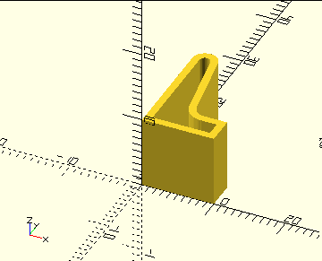

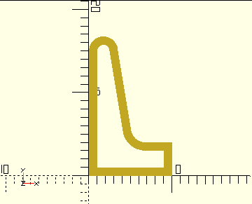

Did I start right? (or is it better to start with a block and remove
unwanted material?)
I'm not quite following the intent of the model, but here's a few
general comments.
First, there are often multiple ways to achieve a goal, and (mostly)
none of them is right or wrong.  If you like to think of a rectangular
box as having six sides, great - build it out of six
appropriately-positioned cube()s.  If, on the other hand, you like to
think of it as a large cube() less a smaller cube()... that's OK too.
Second, be obsessive about indentation and braces.  I won't try to tell
you exactly what style to use, but pick one and be consistent.  The one
big thing is that anything inside braces should be indented further than
the stuff outside the braces.
Third, keep 2D figures on the XY plane, the Z=0 plane.  It's simpler
that way.  Although they look like they are 3D, they aren't, and some
things will not work if you move them off of the XY plane.  Once you
extrude them into being 3D, feel free to move them wherever you want.
In this particular case, I would think of drawing the shape (either the
inner wall or the outer wall) as a 2D object, then using offset() to get
the other wall, then differencing the two to get just the wall, then
extruding it.

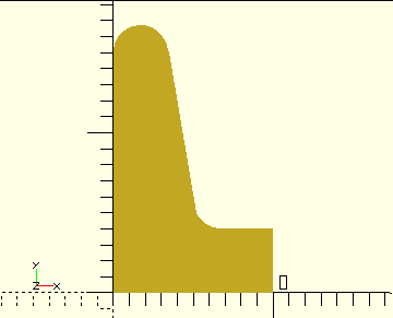

Using a slightly simplified version of your wall() module:
$fa = 12;
$fs = 0.5;
module wall(){
    b =  4;     // botten - tjocklek
    f =  6;     // Foten
    h = 15;     // Höjd
    t =  3.5;   // Top
    x = (b+(t/2) - (h - ( (-h / (f-t)) *t) )) / (-h / (f-t));
    polygon( points=[[0,0], [f,0], [t,h], [0,h]] );
    translate([t/2, h, 0])
    circle(d=t);
    square([10, b]);
        translate([x, b])
            square([t/2, t/2]);
        translate([x+(t/2), b+(t/2), 0])
            circle(d = t);  // Samma radie som toppen
wall();
I would then do this:
    wall();
    offset(-1) wall();
to get this:
and then this:
linear_extrude(height=10) {
        wall();
        offset(-1) wall();
to get this:

and here's a version of wall() that uses that:
module wall() {
    polygon(concat(
        [[0,0]],
        bez([0,15], [0,17], [3,17.6], [3.5,15], 10),
        bez([5.2,5], [5.4,4.5], [6,4], [7,4], 10),
        [[10,4],[10,0]]
wall();
and produces this:
I derived the numbers by eyeball, first by just reading the coordinates
off of rendering yours, and then by flipping between the two and
tweaking the numbers to make the shapes match.
Note that Bézier curves cannot precisely create circles, though they can
come close.
Of course, you can take my wall() and do the same offset / difference /
linear_extrude processing that I did to yours.

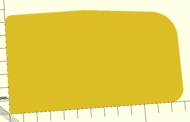

5) A curved wallIs it difficult to place "walls" around a 2D plate?(the dimensions may not fit the previous wall - but the structure is correct)
Assume a base plate with- a corner 90 degrees and- three rounded corners with one radius each and- in the middle an "offset"like this 2D modell .:
$fn = 100;  //Upplösning
// Variabler bottenradCorn1 = 10;  // Radie1radCorn2 = 20;  // Radie2radCorn3 =  5;  // Radie3offset = 5; // offsetbaseX = 120;baseY = 50;
basePlate();
module basePlate();{   hull(){    square(10);    translate([baseX, radCorn1, 0]) circle(r=radCorn1);                            // Corner1    translate([baseX-abs(radCorn1-radCorn2), baseY, 0]) circle(r=radCorn2);       // Corner2    translate([baseX/2, baseY+offset, 0]) circle(r=radCorn2);                     // Offset    translate([radCorn3, baseY+radCorn2+offset-radCorn3, 0]) circle(r=radCorn3);  // Corner3}}
