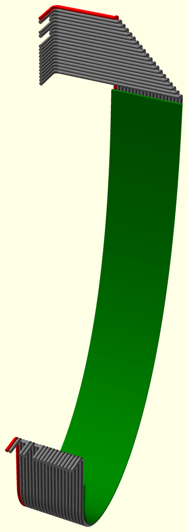

Sat, Feb 2, 2019 7:25 PM
Yes each wire has the fold in a different position, so is a separate sweep.
This is why speed is very important to me.
I make the path out straight lines and arcs plus a Bezier curve in the
middle. That starts with a straight down section under clamps, which is why
the singularity is important to me. It doesn't matter for the wires because
they start horizontally but it does for the strip.
I join sections of path together with routines called before and after.
These take care of translating the start of one path to the end of the
other and removing the duplicate point where they meet.
Since there are big difference between the lengths of my straight segments
and the curved ones I calculate my tangents differently it seems. I
normalise the vectors before I subtract them and then normalise the
difference. That ensures the profile always bisects the angle between them,
regardless of their relative lengths.
This is what the top level code looks like:

I am looking at ways to make it faster. Since the paths are the same before
and after the folded section (actually two variants because I leave some
wires unconnected for clearance for mains), I might try sweeping the start
to a mesh and duplicate the polyhedrons. The problem is OpenSCAD is
currently slow at drawing large identical polyhedrons, so I am waiting to
see how Hans' speed up work progresses.
It currently takes six seconds to compute this:
[image: cable.png]
It seems to be about 2 seconds to calculate the length of the strip and
sweep it, 2 seconds to compute the paths of the wires and 2 seconds to
sweep the wires.
I have realised that co-linear path points are needed to make straight but
twisted sweeps, which I don't currently have.
