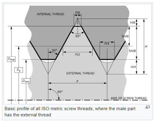

For metric screws the minor diameter is not nominal minus sqrt(3) times the pitch. That is the base of the triangle but it is fillited at 5/8 and 1/8. According to Wikipedia it is the major diameter minus 1.082532 times the pitch. Using standard drill sizes, that is close enough to 1 times the pitch.
<image.png>
<image.png>

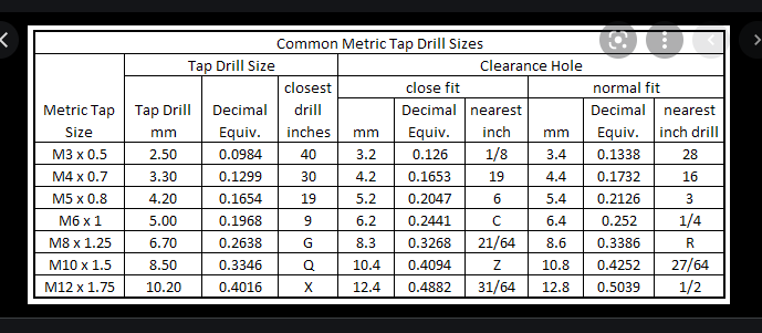

The ideal tap size for machine screws is the nominal OD minus the pitch
  • sqrt(3) * 5 / 8. I.e. the ID of the internal thread. Rounded to the
    nearest drill size it is just nominal minus pitch. If the hole was smaller
    the tap would tend to bind as it has to widen the hole as well as cutting
    the threads. If the hole is too big you get a weak thread because the OD is
    too big.
For self tappers it is more complicated because they are often used in
thin sheets of metal and tables I found online have different values for
different thicknesses. To some extent you are forming the metal, rather
than just cutting it. But for thick materials I just use the thread ID,
which I often measure with calipers or eyeball the drill against the screw.
times the pitch.

On Nov 3, 2021, at 04:05, nop head <nop.head@gmail.com
<image.png>

For metric machine screws the pilot hole for tapping is just the outer diameter minus the pitch. For self tappers and wood screws I think to some extent it depends on the material it goes into and its thickness. I either google it or measure the minor diameter with calipers and use that.
I have some constants for No 2, 4, 6, and 8 screws in my library but I just noticed No4 and No6 are both 2mm holes and I can't remember why. The comments do say into soft wood and it must have been the drill I used making my first Mendel90 out of MDF. It doesn't really matter much into soft wood but it is more important for printed holes.
pitch.
