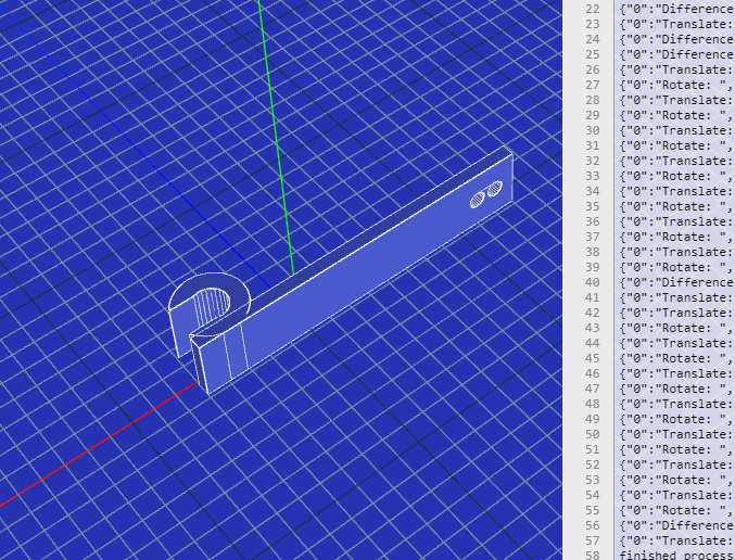

Hi Alex,
I think Minkowski is a great idea so I have started doing an
implementation. Minkowski is an example of something quite a bit more
complex in the OpenSCAD that is welded to the CGAL. Alongside that I will
also be doing a more direct port of the primitives so that the '$' options
work as expected. Aside from fillets what else can you do with the
Minkowiski?

Next challenge:  Minkowski.  I use it all. The. Time.
I just tried:
minkowski()
 cube([20,20,20],center=true);
 cylinder(20,20,20,center=true);
AND – this is maybe the biggest useful feedback for your development…
Right now if it doesn’t understand something, you get zero response.  If
you want to get traction for this, let’s make it a game between you and
trial users?
Better:
“Sorry, I don’t understand that”
Much Better:
“Sorry, I don’t know the function ‘minkowski()’ ”
Even better:
“Sorry, I don’t know the function ‘minkowski()’, this has been logged,
check the development roadmap HERE”

Hi Alex, I think Minkowski is a great idea so I have started doing an implementation. Minkowski is an example of something quite a bit more complex in the OpenSCAD that is welded to the CGAL. Alongside that I will also be doing a more direct port of the primitives so that the '$' options work as expected. Aside from fillets what else can you do with the Minkowiski? On Fri, Jul 21, 2017 at 6:35 PM, Alex Gibson <alex@alexgibson.net> wrote: > Next challenge: Minkowski. I use it all. The. Time. > > > > I just tried: > > > > minkowski() > > { > > cube([20,20,20],center=true); > > cylinder(20,20,20,center=true); > > } > > > > AND – this is maybe the biggest useful feedback for your development… > > > > Right now if it doesn’t understand something, you get zero response. If > you want to get traction for this, let’s make it a game between you and > trial users? > > > > Better: > > “Sorry, I don’t understand that” > > Much Better: > > “Sorry, I don’t know the function ‘minkowski()’ ” > > Even better: > > “Sorry, I don’t know the function ‘minkowski()’, this has been logged, > check the development roadmap HERE” > > - If you’re going for OpenSCAD compatibility – and it’s online – > how about flagging back to you every time a function is hit that your app > does not understand, like an ‘upvote’. You could host a page showing how > many times people were encountering each of the unknown functions, and > other kinds of error, it will give you and the people trying the app > instant visibility of where the biggest wins are, and you could also > comment on your own intentions? > > > > Would you like a discussion by phone/Hangout/etc in the week of 31st > July-4th August? I can think of some exciting applications for this in > my own work and would love to chat… > > > > > > > > *From:* Alex Gibson [mailto:alex@alexgibson.net] > *Sent:* 21 July 2017 09:21 > *To:* 'OpenSCAD general discussion' > *Subject:* RE: [OpenSCAD] Project Announcement Makertron > > > > Hi Damian, > > > > Pleased to confirm the change you made works for me – first time I have > seen it make something of mine and it’s great that you updated it so fast, > so I am encouraged to throw more things at it and try to break it again J > > > > Before I go deep – can I ask if you can elaborate on protection of > intellectual property pasted into this box? IF you’re taking this to any > serious level, people will want to know what happens to their designs – I > for one would be keen to clarify. > > > > Also, in the vein of preparing for success, would you be able to make this > in the form of an ‘embeddable widget’? It would be amazing if I could use > this sort of thing to edit models and push them to a page on my website, > for example, so people can see the latest tweaks! > > > > > > I can confirm the left-button-pan works, and right-button-move only goes > down-right for me too. Chrome on Windows 7. > > > > Cheers > > Alex > > > > *From:* Discuss [mailto:discuss-bounces@lists.openscad.org > <discuss-bounces@lists.openscad.org>] *On Behalf Of *Damien Towning > *Sent:* 21 July 2017 08:24 > *To:* OpenSCAD general discussion > *Subject:* Re: [OpenSCAD] Project Announcement Makertron > > > > Hi Alex, > > > I pushed a new update out today with some improved argument parsing. I see > that nice little example you gave now loads. I'll be sorting out some sort > of supported features matrix and a time line as well. Just a lot to get > done :) > > > > On Thu, Jul 20, 2017 at 4:26 PM, Torsten Paul <Torsten.Paul@gmx.de> wrote: > > On github it says: > > > Lastly the OpenSCAD parser while supporting an excellent CSG language > > ( though in some areas ambiguous ) is so glued to the interface and > > supporting code that it is hard for the language to evolve or move > > forwards from that interface. It is our opinion that this effort has > > stalled and something new needed to be developed to address these > > issues. > > > If that's one of the core premises, I'd suggest to have a look at > http://apidesign.org/ > > Also it would be interesting to have a look at that geometry engine > (quote "The Makertron server supports its own internal geometry > engine based on a BREP representation.") which seems to be based on > Open Cascade. I can only find shared libs in the server repo. > > ciao, > Torsten. > > > _______________________________________________ > OpenSCAD mailing list > Discuss@lists.openscad.org > http://lists.openscad.org/mailman/listinfo/discuss_lists.openscad.org > > > > > > -- > > Damien Towning > CEO / Developer > http://makertron.io > > > > _______________________________________________ > OpenSCAD mailing list > Discuss@lists.openscad.org > http://lists.openscad.org/mailman/listinfo/discuss_lists.openscad.org > > -- Damien Towning CEO / Developer http://makertron.io
Sat, Jul 22, 2017 11:27 PM
Minkowski looks pretty easy to implement compared to things like union.
IIRC for a convex shape it is just a hull of the set of the set of points
summed with the other set. For a concave shape it can be decomposed to
convex shapes and then it is a union of resulting hulls().
