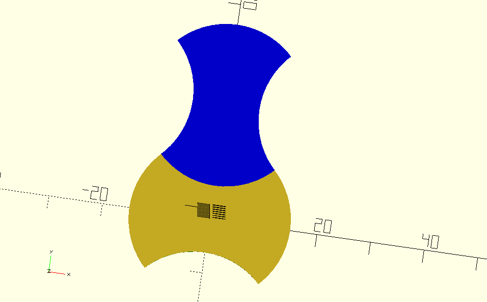

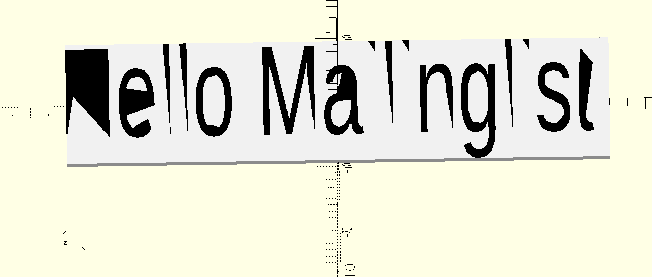

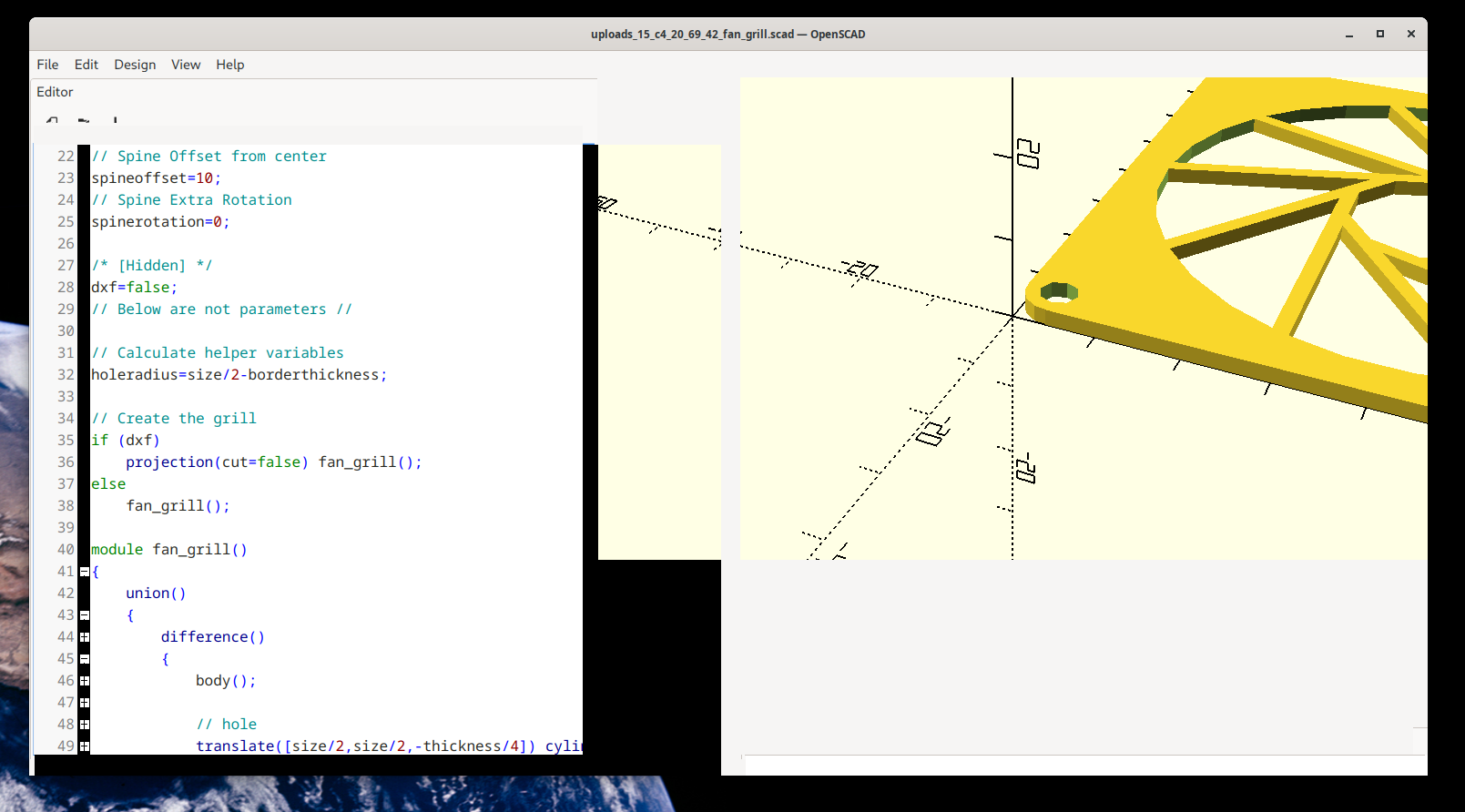

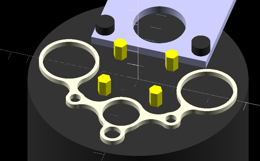

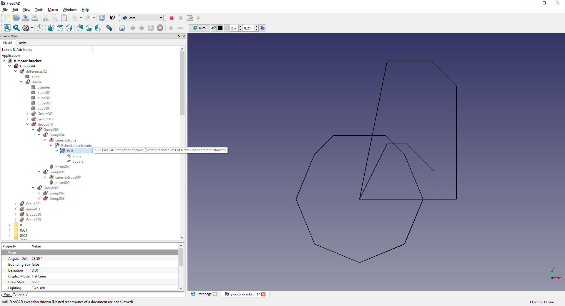

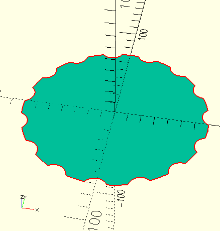

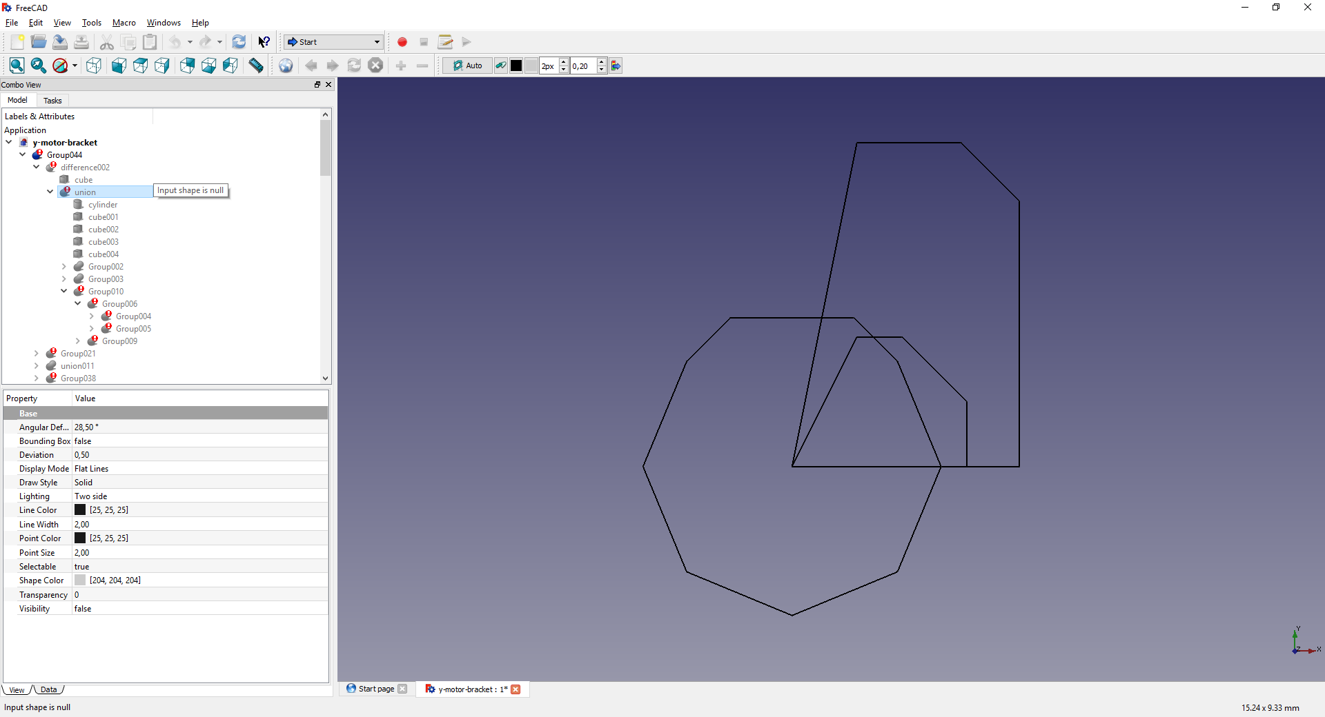

I have an svg that was generated by projection().
I would like to use offset_sweep with a rounding on top to generate a
solid.
I have only managed to find a few examples, all of which use a
generated path. Can I use what I have to do this? If so, how do I tell
it that it's a path?
Attached is an image of the imported svg.
I have an svg that was generated by projection(). I would like to use offset_sweep with a rounding on top to generate a solid. I have only managed to find a few examples, all of which use a generated path. Can I use what I have to do this? If so, how do I tell it that it's a path? Attached is an image of the imported svg.
Wed, Sep 23, 2026 9:03 PM
As per the recent discussion here about svg imports, there's no easy way.
You can convert your svg file and use the pathbuilder library, or somehow
else convert it to numerical data and embed it in your code.  When you
import the svg you get geometry and there's no way to make it a path.

Wed, Sep 23, 2026 10:00 PM
way.  You can convert your svg file and use the pathbuilder library,
or somehow else convert it to numerical data and embed it in your
code.  When you import the svg you get geometry and there's no way to
make it a path.
Thanks. I was afraid of that.
So if I linear_extrude that is there any way to round the top edge?
Larry

I looked at that and visualize it as a 3d difference, big circle for the
first line of the function, followed by a for loop for the second line
of the difference, interchanging the angle and distance so the for
variable of 15 functions as the angle, effectively becoming a
polar/rectangular conversion, drawing what you have with 2 or 3 lines of
code. Then wrap that in whatever is needed for a printable 3d object.
Remember that cylinder can have two diameter arguments if tapering is
needed.
Its an interesting what if.

 The BOLS2 library may have something usefull, or there is "minkowski"
a bit of a bear to use and a cpu heater but it does work once you
understand it.

Use minkowski?  Construct a stairstep of offsets at a fine enough
resolution that you don't mind the stairsteps.
I adapted BOSL2's convex_offset_extrude() to use roof() instead of hull()
to make offset_extrude() so it works with concave objects such as yours.
Takes the same parameters so you can specify chamfer, rounding, teardrop,
etc. independently for the  bottom and top edges.  Here's the code:
