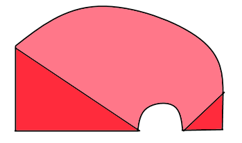

I am sort of new and I manage to get along but probably not in the best
or most efficient way. I marvel at some of the code I see. I want to
create this and want to know the best way. All I come up with is a
series of thin triangles in a arc, each a different size. How do I do it?
thanks
Lee

If those a circular arcs, it's a really easy case for difference(). If not, you can probably still do it that way, but depending on how you want to define the curves, a chain hull might be easier.

I think you need to give more information about what you're trying to create.
Is the shape defined by the dimensions of the triangles?  The space between
them?  Or maybe by some dimensions and some angles?  And then an altitude?
Are the arcs circles?  They don't look like it, so maybe not.  What defines
the arcs?
I think knowing exactly what you're trying to create is an important first
step.

I know about Hull but what is a Chain Hull?
Lee

It is defined by the dimensions of the triangles.
I am trying to figure out how to explain it. Imagine a triangular 'rod'
that diminishes in size in all three dimensions from one end to the
other. Then bend that rod into a U shape. So it is a solid piece. The
inner arc is small and could be a circle. The outer arc is almost half a
circle but a bit elliptical. It could be circle if needed. Ideally the
hypotenuse would be a little concave but I was going to live with
straight. I was hoping a picture was worth a lot of words.

Your picture looked like a flat 2d picture of triangles and an arc.  So Is
this sort of like what you're after?
http://forum.openscad.org/file/t2477/thing.png
Note: the triangles are coplanar but it doesn't look like it because of the
shrinkage along the length which means the small one is not aligned with the
big one.

It is supposed to be 3D.
I would say the inverse of your image with the pointy tip on the inside.
Take a bowl and pull/stretch the bottom center to the right side a bit.
Then cut it in half vertically with the blade going left to right.
Trying to go from my mind to your mind without telepathy and not coming
up with the right words.
How did you do your example? Maybe I can just reverse that.
I would like to smooth it by using something better than triangles, some
shape I design with rounding.
Lee

 So Is this sort of like what you're after?
of the shrinkage along the length which means the small one is not
aligned with the big one.
    'rod'
The
    half a
    the
    Lee

People seem to have a very hard time to imagine what you actually want. 1) Do I already have one of these in my home? 2) Is it a replacement part? 3) What does it have to mesh/interface with? 4) What are the critical or known dimensions? What dimensions don't really matter? 5) What are the critical areas in the shape? Distance between points on your drawing or radius of curves, etc. 6) If you don't bend it over, what would it look like (dimensions and important radia please) I don't recall seeing anything like this in my house. On 2021-02-25 6:19 p.m., Lee A wrote: > It is supposed to be 3D. > > I would say the inverse of your image with the pointy tip on the inside. > > Take a bowl and pull/stretch the bottom center to the right side a > bit. Then cut it in half vertically with the blade going left to > right. Trying to go from my mind to your mind without telepathy and > not coming up with the right words. > > How did you do your example? Maybe I can just reverse that. > > I would like to smooth it by using something better than triangles, > some shape I design with rounding. > > Lee > > On 2/25/2021 4:37 PM, adrianv wrote: >> Your picture looked like a flat 2d picture of triangles and an arc. >>  So Is this sort of like what you're after? >> >> >> >> Note: the triangles are coplanar but it doesn't look like it because >> of the shrinkage along the length which means the small one is not >> aligned with the big one. >> >>     Leea wrote >>     It is defined by the dimensions of the triangles. >>     I am trying to figure out how to explain it. Imagine a triangular >>     'rod' >>     that diminishes in size in all three dimensions from one end to the >>     other. Then bend that rod into a U shape. So it is a solid piece. >> The >>     inner arc is small and could be a circle. The outer arc is almost >>     half a >>     circle but a bit elliptical. It could be circle if needed. Ideally >>     the >>     hypotenuse would be a little concave but I was going to live with >>     straight. I was hoping a picture was worth a lot of words. >> >>     Lee >> >>     On 2/25/2021 3:59 PM, adrianv wrote: >>     > I think you need to give more information about what you're >>     trying to >>     > create.  Is the shape defined by the dimensions of the >>     triangles?  The >>     > space between them?  Or maybe by some dimensions and some >>     angles?  And >>     > then an altitude?   Are the arcs circles? They don't look like >>     it, so >>     > maybe not.  What defines the arcs? >>     > >>     > I think knowing exactly what you're trying to create is an >>     important >>     > first step. >>     > >>     >     Leea wrote >>     >     I am sort of new and I manage to get along but probably not >>     in the >>     >     best >>     >     or most efficient way. I marvel at some of the code I see. I >>     want to >>     >     create this and want to know the best way. All I come up >>     with is a >>     >     series of thin triangles in a arc, each a different size. >>     How do I >>     >     do it? >>     > >>     > >>     > >>     >     thanks >>     >     Lee >>     > >>     > >>     > >>     > >>     >     _______________________________________________ >>     >     OpenSCAD mailing list >>     >     [hidden email] >>     > </user/SendEmail.jtp?type=email&email=Discuss%40.openscad> >>     > >> http://lists.openscad.org/mailman/listinfo/discuss_lists.openscad.org >> <http://lists.openscad.org/mailman/listinfo/discuss_lists.openscad.org> >>     > >> <http://lists.openscad.org/mailman/listinfo/discuss_lists.openscad.org> >> <http://lists.openscad.org/mailman/listinfo/discuss_lists.openscad.org>> >>     > >>     > >>     >     curve.png (10K) >>     > <http://forum.openscad.org/attachment/31966/0/curve.png> >> <http://forum.openscad.org/attachment/31966/0/curve.png>> >>     > <http://forum.openscad.org/attachment/31966/0/curve.png> >> <http://forum.openscad.org/attachment/31966/0/curve.png>>> >>     > >>     > >>     > >> ------------------------------------------------------------------------ >> >>     > Sent from the OpenSCAD mailing list archive >>     > <http://forum.openscad.org/> <http://forum.openscad.org/>> at >>     Nabble.com. >>     > >>     > _______________________________________________ >>     > OpenSCAD mailing list >>     > [hidden email] >> </user/SendEmail.jtp?type=email&email=Discuss%40.openscad> >>     > >> http://lists.openscad.org/mailman/listinfo/discuss_lists.openscad.org >> <http://lists.openscad.org/mailman/listinfo/discuss_lists.openscad.org> >> >> >>     _______________________________________________ >>     OpenSCAD mailing list >>     [hidden email] >> </user/SendEmail.jtp?type=email&email=Discuss%40.openscad> >> http://lists.openscad.org/mailman/listinfo/discuss_lists.openscad.org >> <http://lists.openscad.org/mailman/listinfo/discuss_lists.openscad.org> >> >> >> ------------------------------------------------------------------------ >> Sent from the OpenSCAD mailing list archive >> <http://forum.openscad.org/> at Nabble.com. >> >> _______________________________________________ >> OpenSCAD mailing list >> Discuss@lists.openscad.org >> http://lists.openscad.org/mailman/listinfo/discuss_lists.openscad.org > > > _______________________________________________ > OpenSCAD mailing list > Discuss@lists.openscad.org > http://lists.openscad.org/mailman/listinfo/discuss_lists.openscad.org -- Ron Wheeler Artifact Software 438-345-3369 rwheeler@artifact-software.com
DS
Daniel Shriver
Fri, Feb 26, 2021 2:40 AM
It looks like a simplified version of an amphitheater (instead of steps,
the smooth hypotenuse of a triangle) where the triangle shrinks as it moves
around.  The bottom side appears (in his first drawing) to be flat and
flush with a horizontal surface.  Also, instead of being bent along a
semicircle, as the poster mentions it is bent along a U.  The poster makes
it a little more complicated by saying the curved part of the U is not
circular but elliptical (and then even more complicated saying the
hypotenuse should be concave).
No dimensions have been specified, relative dimensions would help.
Likewise, something describing the curvatures would also help (when you say
"elliptical" do you mean like a standard ellipse, or a parabola, or
hyperbolic curves....)
Then cut it in half vertically with the blade going left to right. Trying
to go from my mind to your mind without telepathy and not coming up with
the right words.
Lee

In OpenSCAD ultimately everything is a triangle.  (Maybe you can make
rectangles too?)  There are no curves.  So I'm not sure what you're hoping
for about "something better than triangles".  Do you mean for the end of the
shape?
You said you want the hypotenuse a little concave?  So here's a new version.
My code is based on the BOSL2 library.  You might be able to make a shape
like this without a library by subtracting a sphere from a cylinder.  It
would be more symmetric, though.  The outer arc of th shape produced by the
code below is not a circle.
https://github.com/revarbat/BOSL2/wiki
include <BOSL2/skin.scad>
include <BOSL2/turtle3d.scad>
include <BOSL2/rounding.scad>
$fn=128;
width = 10;
height = 8;
curve=2;  // Amount to curve hypotenuse inward
normal = line_normal([[-height,width],[0,0]]);
//triangle = [[-height,width],[0,0],[0,width]];  // Straight side triangle
triangle = [ each arc(points=[[-height,width],
[-height,width]/2+normal*curve, [0,0]]),
[0,0],
[0,width]
trans = turtle3d([
["arc", 4, "right", 180, "shrink", 2]
],transforms=true);
sweep(triangle, trans);
http://forum.openscad.org/file/t2477/thing2.png
