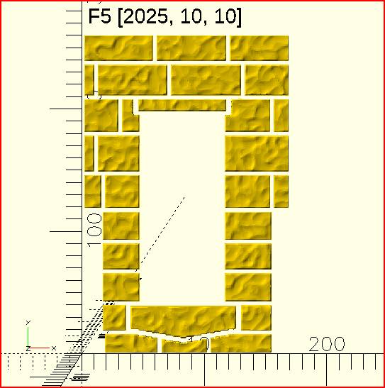

I'm working on a program that generates stone walls from images. I use
OpenCV to extract the stone contours, which I combine with textures
produced using a libnoise-based command line tool I wrote and the
Manifold mesh library to make the stones.  The program saves them as
individual .3mf files.

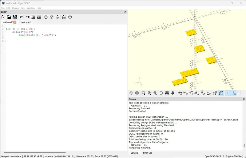

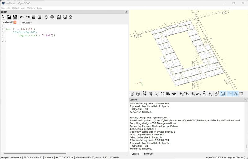

When I import the stones to do the further work in OpenSCAD (wall
backing, window/door cutout and placement, etc.), the OpenSCAD behavior
is definitely regressive.  Here's what it should look like:
Note the script in the editor, it loops through the import command
constructing file names with str().  That goes well enough, but when I
try to do anything else with the stones, like add the color() operator,
I get this:
Most of the stones don't render, with no discernible pattern to which
are lucky.  If I try to export this, I get what is seen. Interestingly,
I can run the same script through command-line OpenSCAD and it works fine.
This is with dev version 2025-10-10.  I downloaded the 2021 release
version, and it works just fine 'cept for the gawd-awful slow CGAL...
I can open an issue at the repo, thought I'd float it here first.

Glenn, are you able to share the .3mf files?
At face value it looks like a bug.
I'm happy to have a closer look.

.zip file attached.  I also included wall.scad, which has the loop to
import the files.  Comment-out the color() line to get nominal behavior.

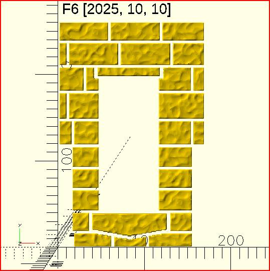

Michael Marx (spintel)
Mon, Oct 13, 2025 6:06 AM
Works with 2021.1 (as expected), but also 2025.10.10 (& 2025.08.31) - only ones installed ATM.
Exported a STL which looks normal.
So, thinking cap ON, what could cause it to be different on another system... hmmm....

On 10/13/2025 12:15 AM, Michael Marx (spintel) via Discuss wrote:
Glenn, please attach a text file with Help/Library_Info.
OpenSCAD Version: 2025.10.10 (git eb59629ad) System information: Microsoft Windows 11 (10.0.26200) x86_64 8 CPUs 7.60 GB RAM User Agent: OpenSCAD/2025.10.10 (git eb59629ad) (Microsoft Windows 11 (10.0.26200) x86_64) Compiler: GCC "14.3.0" 64bit MinGW build: MingW64 Debug build: No Boost version: 1_85 Eigen version: 3.4.0 CGAL version, kernels: 6.0.1, Cartesian<Gmpq>, Extended_cartesian<Gmpq> OpenCSG version: OpenCSG 1.5.0 Clipper2 version: 1.5.2 Manifold version: 3.2.1 Qt version: 5.15.17 QScintilla version: 2.11.2 InputDrivers: GLib version: 2.85.3 lodepng version: 20230410 libzip version: 1.5.2 fontconfig version: 2.16.0 freetype version: 2.13.3 harfbuzz version: 11.4.1 cairo version: 1.18.4 lib3mf version: 1.8.1 Features: roof, input-driver-dbus, lazy-union*, vertex-object-renderers-indexing*, textmetrics, import-function, object-function, predictible-output Application Path: C:/Users/glenn/Documents/OpenSCAD-2025.10.10-x86-64 Documents Path: C:\Users\glenn\Documents User Documents Path: C:\Users\glenn\Documents Resource Path: C:/Users/glenn/Documents/OpenSCAD-2025.10.10-x86-64 User Library Path: C:/Users/glenn/Documents/OpenSCAD/libraries User Examples Path: C:/Users/glenn/Documents/OpenSCAD/examples User Config Path: C:\Users\glenn\AppData\Local/OpenSCAD Backup Path: C:/Users/glenn/Documents/OpenSCAD/backups OPENSCADPATH: <not set> OpenSCAD library path: C:/Users/glenn/Documents/OpenSCAD/libraries C:/Users/glenn/Documents/OpenSCAD-2025.10.10-x86-64\libraries OPENSCAD_FONT_PATH: <not set> OpenSCAD font path: C:/WINDOWS/fonts C:/Users/glenn/AppData/Local/Microsoft/Windows/Fonts C:/Users/glenn/.local/share/fonts C:/usr/local/share/fonts C:/usr/share/fonts C:/usr/X11/lib/X11/fonts C:/System/Library/Fonts C:/Library/Fonts C:/Users/glenn/Library/Fonts GLEW version: 2.1.0 OpenGL Version: 4.6.0 - Build 31.0.101.2130 GL Renderer: Intel(R) Iris(R) Plus Graphics GL Vendor: Intel RGBA(8888), depth(24), stencil(8) GL_ARB_framebuffer_object: yes GL_EXT_framebuffer_object: yes GL_EXT_packed_depth_stencil: yes Qt graphics widget: QOpenGLWidget QSurfaceFormat: RGBA(8888), depth(24), stencil(8) GL Extensions: GL_3DFX_texture_compression_FXT1 GL_AMD_depth_clamp_separate GL_AMD_vertex_shader_layer GL_AMD_vertex_shader_viewport_index GL_ARB_ES2_compatibility GL_ARB_ES3_1_compatibility GL_ARB_ES3_compatibility GL_ARB_arrays_of_arrays GL_ARB_base_instance GL_ARB_bindless_texture GL_ARB_blend_func_extended GL_ARB_buffer_storage GL_ARB_cl_event GL_ARB_clear_buffer_object GL_ARB_clear_texture GL_ARB_clip_control GL_ARB_color_buffer_float GL_ARB_compatibility GL_ARB_compressed_texture_pixel_storage GL_ARB_compute_shader GL_ARB_conditional_render_inverted GL_ARB_conservative_depth GL_ARB_copy_buffer GL_ARB_copy_image GL_ARB_cull_distance GL_ARB_debug_output GL_ARB_depth_buffer_float GL_ARB_depth_clamp GL_ARB_depth_texture GL_ARB_derivative_control GL_ARB_direct_state_access GL_ARB_draw_buffers GL_ARB_draw_buffers_blend GL_ARB_draw_elements_base_vertex GL_ARB_draw_indirect GL_ARB_draw_instanced GL_ARB_enhanced_layouts GL_ARB_explicit_attrib_location GL_ARB_explicit_uniform_location GL_ARB_fragment_coord_conventions GL_ARB_fragment_layer_viewport GL_ARB_fragment_program GL_ARB_fragment_program_shadow GL_ARB_fragment_shader GL_ARB_fragment_shader_interlock GL_ARB_framebuffer_no_attachments GL_ARB_framebuffer_object GL_ARB_framebuffer_sRGB GL_ARB_geometry_shader4 GL_ARB_get_program_binary GL_ARB_get_texture_sub_image GL_ARB_gl_spirv GL_ARB_gpu_shader5 GL_ARB_gpu_shader_fp64 GL_ARB_half_float_pixel GL_ARB_half_float_vertex GL_ARB_indirect_parameters GL_ARB_instanced_arrays GL_ARB_internalformat_query GL_ARB_internalformat_query2 GL_ARB_invalidate_subdata GL_ARB_map_buffer_alignment GL_ARB_map_buffer_range GL_ARB_multi_bind GL_ARB_multi_draw_indirect GL_ARB_multisample GL_ARB_multitexture GL_ARB_occlusion_query GL_ARB_occlusion_query2 GL_ARB_pipeline_statistics_query GL_ARB_pixel_buffer_object GL_ARB_point_parameters GL_ARB_point_sprite GL_ARB_polygon_offset_clamp GL_ARB_post_depth_coverage GL_ARB_program_interface_query GL_ARB_provoking_vertex GL_ARB_query_buffer_object GL_ARB_robust_buffer_access_behavior GL_ARB_robustness GL_ARB_robustness_isolation GL_ARB_sample_shading GL_ARB_sampler_objects GL_ARB_seamless_cube_map GL_ARB_seamless_cubemap_per_texture GL_ARB_separate_shader_objects GL_ARB_shader_atomic_counter_ops GL_ARB_shader_atomic_counters GL_ARB_shader_bit_encoding GL_ARB_shader_draw_parameters GL_ARB_shader_group_vote GL_ARB_shader_image_load_store GL_ARB_shader_image_size GL_ARB_shader_objects GL_ARB_shader_precision GL_ARB_shader_stencil_export GL_ARB_shader_storage_buffer_object GL_ARB_shader_subroutine GL_ARB_shader_texture_image_samples GL_ARB_shading_language_100 GL_ARB_shading_language_420pack GL_ARB_shading_language_packing GL_ARB_shadow GL_ARB_spirv_extensions GL_ARB_stencil_texturing GL_ARB_sync GL_ARB_tessellation_shader GL_ARB_texture_barrier GL_ARB_texture_border_clamp GL_ARB_texture_buffer_object GL_ARB_texture_buffer_object_rgb32 GL_ARB_texture_buffer_range GL_ARB_texture_compression GL_ARB_texture_compression_bptc GL_ARB_texture_compression_rgtc GL_ARB_texture_cube_map GL_ARB_texture_cube_map_array GL_ARB_texture_env_add GL_ARB_texture_env_combine GL_ARB_texture_env_crossbar GL_ARB_texture_env_dot3 GL_ARB_texture_filter_anisotropic GL_ARB_texture_float GL_ARB_texture_gather GL_ARB_texture_mirror_clamp_to_edge GL_ARB_texture_mirrored_repeat GL_ARB_texture_multisample GL_ARB_texture_non_power_of_two GL_ARB_texture_query_levels GL_ARB_texture_query_lod GL_ARB_texture_rectangle GL_ARB_texture_rg GL_ARB_texture_rgb10_a2ui GL_ARB_texture_stencil8 GL_ARB_texture_storage GL_ARB_texture_storage_multisample GL_ARB_texture_swizzle GL_ARB_texture_view GL_ARB_timer_query GL_ARB_transform_feedback2 GL_ARB_transform_feedback3 GL_ARB_transform_feedback_instanced GL_ARB_transform_feedback_overflow_query GL_ARB_transpose_matrix GL_ARB_uniform_buffer_object GL_ARB_vertex_array_bgra GL_ARB_vertex_array_object GL_ARB_vertex_attrib_64bit GL_ARB_vertex_attrib_binding GL_ARB_vertex_buffer_object GL_ARB_vertex_program GL_ARB_vertex_shader GL_ARB_vertex_type_10f_11f_11f_rev GL_ARB_vertex_type_2_10_10_10_rev GL_ARB_viewport_array GL_ARB_window_pos GL_ATI_separate_stencil GL_EXT_abgr GL_EXT_bgra GL_EXT_blend_color GL_EXT_blend_equation_separate GL_EXT_blend_func_separate GL_EXT_blend_minmax GL_EXT_blend_subtract GL_EXT_clip_volume_hint GL_EXT_compiled_vertex_array GL_EXT_direct_state_access GL_EXT_draw_buffers2 GL_EXT_draw_range_elements GL_EXT_fog_coord GL_EXT_framebuffer_blit GL_EXT_framebuffer_multisample GL_EXT_framebuffer_object GL_EXT_geometry_shader4 GL_EXT_gpu_program_parameters GL_EXT_gpu_shader4 GL_EXT_memory_object GL_EXT_memory_object_win32 GL_EXT_multi_draw_arrays GL_EXT_packed_depth_stencil GL_EXT_packed_float GL_EXT_packed_pixels GL_EXT_polygon_offset_clamp GL_EXT_rescale_normal GL_EXT_secondary_color GL_EXT_semaphore GL_EXT_semaphore_win32 GL_EXT_separate_specular_color GL_EXT_shader_framebuffer_fetch GL_EXT_shader_integer_mix GL_EXT_shadow_funcs GL_EXT_stencil_two_side GL_EXT_stencil_wrap GL_EXT_texture3D GL_EXT_texture_array GL_EXT_texture_compression_s3tc GL_EXT_texture_edge_clamp GL_EXT_texture_env_add GL_EXT_texture_env_combine GL_EXT_texture_filter_anisotropic GL_EXT_texture_integer GL_EXT_texture_lod_bias GL_EXT_texture_rectangle GL_EXT_texture_sRGB GL_EXT_texture_sRGB_decode GL_EXT_texture_shared_exponent GL_EXT_texture_snorm GL_EXT_texture_storage GL_EXT_texture_swizzle GL_EXT_timer_query GL_EXT_transform_feedback GL_IBM_texture_mirrored_repeat GL_INTEL_coarse_fragment_shader GL_INTEL_conservative_rasterization GL_INTEL_fragment_shader_ordering GL_INTEL_framebuffer_CMAA GL_INTEL_map_texture GL_INTEL_multi_rate_fragment_shader GL_INTEL_performance_query GL_KHR_blend_equation_advanced GL_KHR_blend_equation_advanced_coherent GL_KHR_context_flush_control GL_KHR_debug GL_KHR_no_error GL_KHR_shader_subgroup GL_KHR_shader_subgroup_arithmetic GL_KHR_shader_subgroup_ballot GL_KHR_shader_subgroup_basic GL_KHR_shader_subgroup_clustered GL_KHR_shader_subgroup_quad GL_KHR_shader_subgroup_shuffle GL_KHR_shader_subgroup_shuffle_relative GL_KHR_shader_subgroup_vote GL_KHR_texture_compression_astc_ldr GL_NV_blend_square GL_NV_conditional_render GL_NV_primitive_restart GL_NV_texgen_reflection GL_SGIS_generate_mipmap GL_SGIS_texture_edge_clamp GL_SGIS_texture_lod GL_SUN_multi_draw_arrays GL_WIN_swap_hint WGL_EXT_swap_control On 10/13/2025 12:15 AM, Michael Marx (spintel) via Discuss wrote: > > Glenn, please attach a text file with Help/Library_Info. > > > _______________________________________________ > OpenSCAD mailing list > To unsubscribe send an email todiscuss-leave@lists.openscad.org
GB
Glenn Butcher
Mon, Oct 13, 2025 5:01 PM
So, your query got me thinking about cache size.  I changed CGAL Cache
size and PolySet Cache size from 1000MB to 2000MB and it rendered more
stones. I then doubled those two numbers, but it wouldn't render more
stones.
My device is a Windows Surface 7 Pro with 8GB installed memory.
So, your query got me thinking about cache size.  I changed CGAL Cache size and PolySet Cache size from 1000MB to 2000MB and it rendered more stones. I then doubled those two numbers, but it wouldn't render more stones. My device is a Windows Surface 7 Pro with 8GB installed memory. On 10/13/2025 12:15 AM, Michael Marx (spintel) via Discuss wrote: > > Glenn, please attach a text file with Help/Library_Info. > > > _______________________________________________ > OpenSCAD mailing list > To unsubscribe send an email todiscuss-leave@lists.openscad.org
