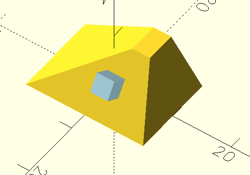

Here's a model with a simple geometric description that would be somewhat
more complicated to make without BOSL2, written without using direction
names:
include<BOSL2/std.scad>
prismoid([14,20],[5,3], h=10, shift=[-2,5])
attach([1,0,0], [0,0,-1])
color("lightblue") cube(3);
The attachment system knows the orientation of the face and puts the object
there.  No user calculation (trigonometry) is needed to figure that out.
