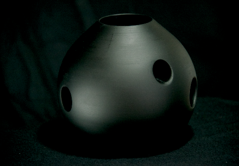

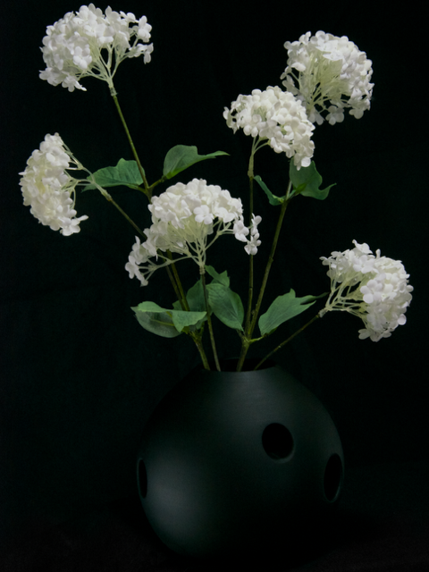

Thought I share the result of the vase design that I showed earlier. Birthday present for my 94 year old mother. Needed a LOT of support for the tubes. I decided to leave the bottom open so that it would be easier to remove after printing. Still turned out that the tubes leaked on the places where the support had been. Fixed this with some superglue.
Made with BOSL2 absolute magic prism_connector ... that is an amazing piece of software.
It did take 3.5 days to print it out.
Peter

Beautiful!  How much filament, and what did you print it on?
superglue.
piece of software.
Peter

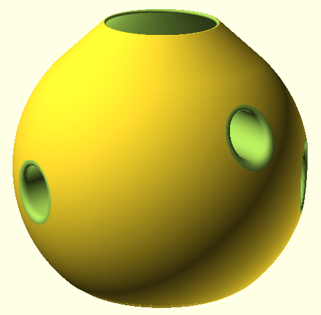

 I wouldn't even know where to start doing the following model (a
 vase as birthday present for my 94 year old mother ...) with
 trigonometry... It uses the 'prism_connector' and the 'parts'
 that Adrian recently added. I therefore only need to specify
 where I want the holes and their size and the tubes and
 roundings are automatically calculated. It really feels like magic.
 <PastedGraphic-1.png><PastedGraphic-3.png>

I used HT Black from ColorFabb https://colorfabb.com/ht-black (printing temp 270 C/120 C plate). Including support it was about 700gram. I had ordered 2kg some time ago for a project where I needed food safety and it is said to be 'FDA Food Contact Compliant' (whatever that means).
I find it not easy to print, it gets elephant feet very easy and for larger rectangular objects it warps too easy. So I had to abandon that project. So I had a about 1.5kg left ...
Peter

What printer?  I can print 700 grams in about 15 hours on my Peopoly Magneto X.  Your 3.5 days seems slow, at least by today's standards.
Just curious
